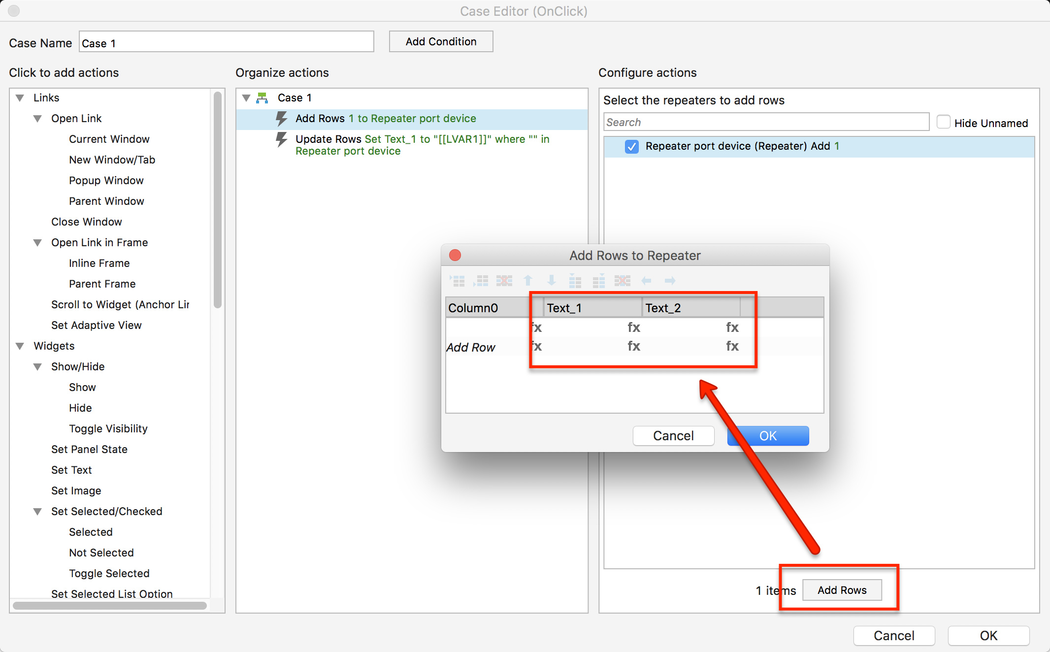

I have created a similar repeater but with a custom dropdown using almost the same “code” as Shiraluk.
My issue is that when I click to add a new row the repeater row updates and gets blank. Sorry if I am vague but I hope it is clear when checking out my rp-file.
You’re so close! The part you were missing was to edit the Add Rows interaction to give the rows being added some data. Currently, the Add Rows IX is adding empty rows to the repeater:
To resolve this, simply edit the entries under Text_1 and Text_2 to target a local variable, e.g. LVAR1, to reference the text on the “Title 1” and “Title 2” widgets . This will add rows to the repeater, pulling text from the widgets you are setting the text to (the droplist selections).
