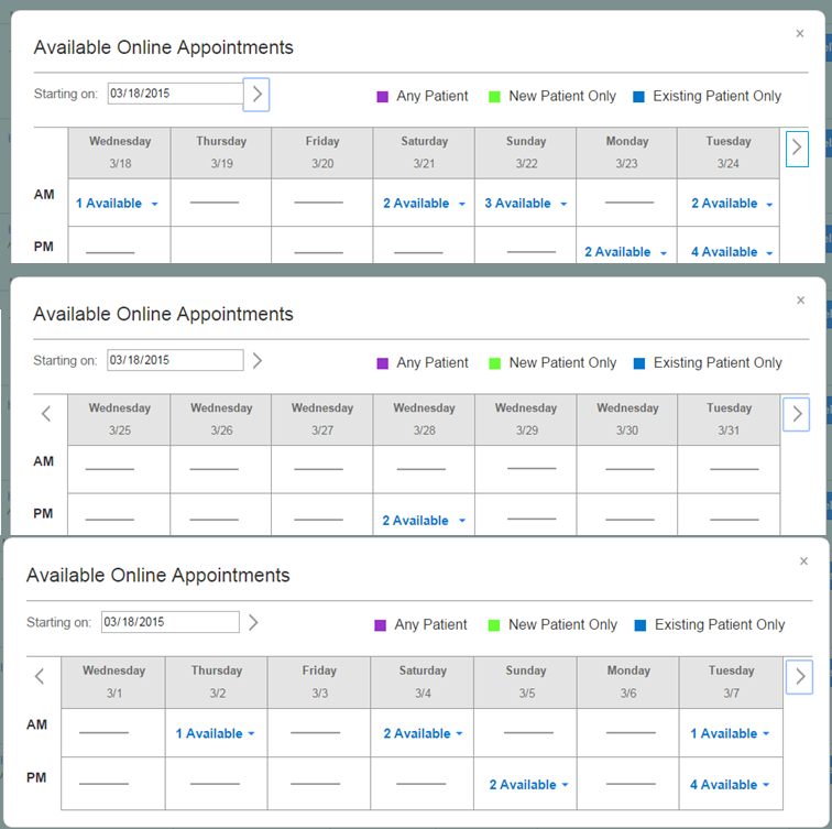

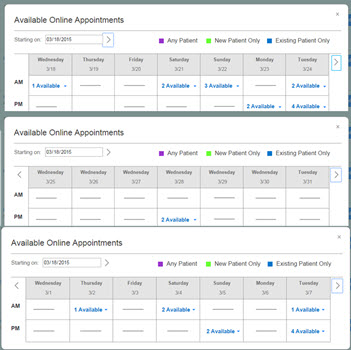

Alyssa - Thanks so much - I’m making headway. The last piece of my puzzle is to also have the date [[Month]]/[[Day]] written below the day of the week, but I’m having trouble coordinating that with the LVAR1 formula. Any suggestions?
So I was able to link the LVAR1 formula to also populate the date. However, I’ve run into a new issue. Because of the format that I need to use (mm/dd), the day is calculated independently from the month. This causes the day to start over but the month remains the same once you reach the end of the current month. Is there a layer of conditional logic that you would suggest to keep this from happening?
I’ve attached a series of screenshots to depict what I’ve describing.
Axure_error.docx (89.1 KB)
Hi again,
For this I think you’ll want to use conditions, as you mentioned. To do that, you’ll want to check if the date in the text field matches a certain day (e.g., 31) and then if that condition returns true, add a month for “Tomorrow”, “2 days after Today”, etc…
Here’s what the condition could look like:
To get the triggered case to add a month, you’ll want to use something like this:
[[LVAR1.addHours(Now.getHours()).addDays(1).getDayOfWeek()]], [[LVAR1.addMonths(1).getMonth()]]/[[LVAR1.addHours(Now.getHours()).addDays(1).getDate()]]
This code in particular would go on on the widget “Tomorrow”, since it adds one day to the selected date. It also adds 1 month to the selected month so if, for example, you selected 3/31/2015, it would display “Wednesday, 4/1” on the “Tomorrow” field. For the rest of the days, you’ll want to also add the method “.addMonths(1)” before the “.getMonth()” portion so that the subsequent widgets also display next month’s date.
The condition in the screenshot only works if the selected date is on the 31st of a month. For other months that don’t end in 31 you’ll want to make a separate condition that checks for that and then runs similar cases. Hopefully that helps!
