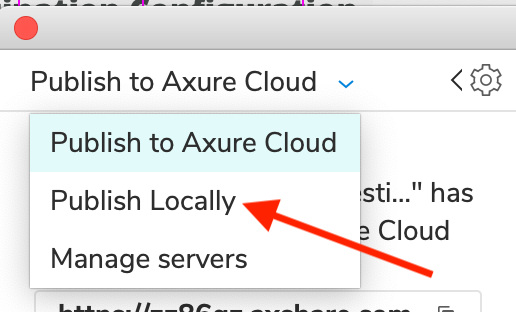

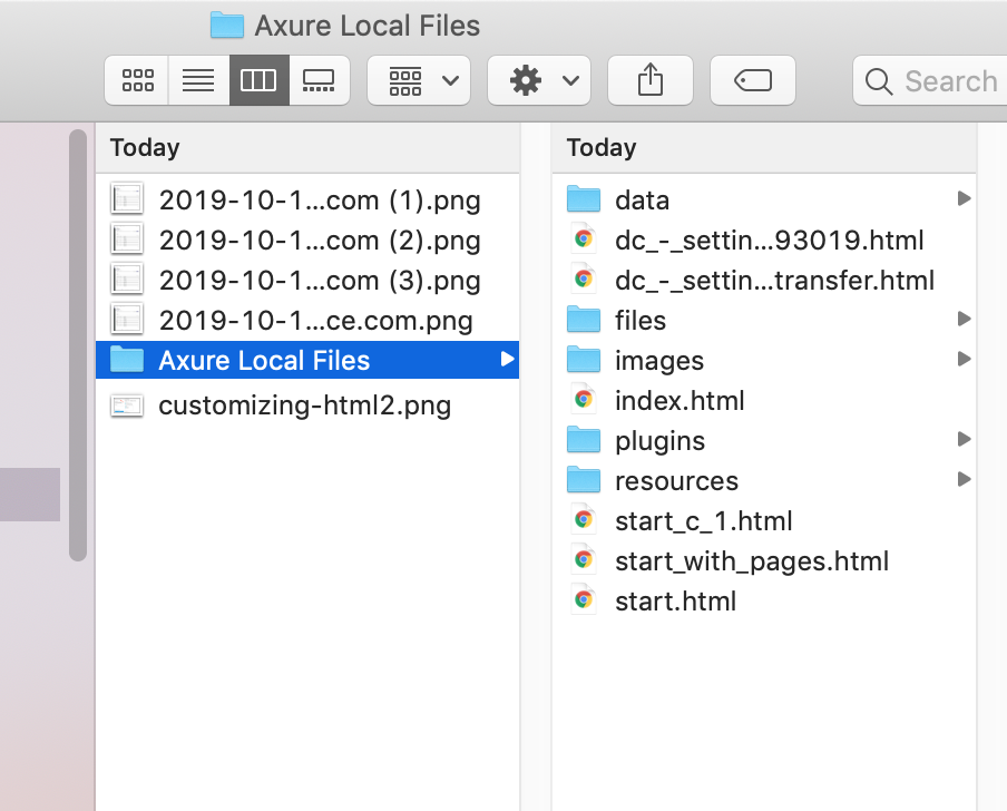

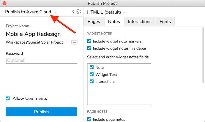

I’m trying to figure this out as well. In RP9 you can publish your Axure comp locally or to AxShare. If you publish locally, it generates the HTML and CSS files. So, if you have the ability to then upload those files to a site you own and have or can add hotjar tracking code, I’m thinking that should work and looking into implementing it. Has anyone else tried and had success with doing it this way?
