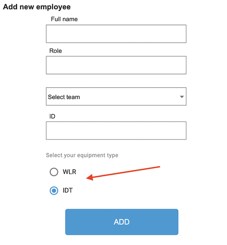

I try to get the value from my radio buttons, into my repeater. I have tried different options but have not been able to make it work ![]()
Is there anyone here who can help me with that? ![]()
Hi Somkazz
File attached
When either of the radio buttons are selected it sets the variable ‘OnLoadVariable’ to be the same as the text on the radio widget. And the ‘Add’ button creates a repeater row using the variable for the equipment column.
After creating the row the ‘Add’ button then resets all the inputs to be empty or default - an important step!
Regards - M
radio_buttons.rp (58.4 KB)
(I’ve not added any conditionality on the Add button for populated fields - but you should/could)
