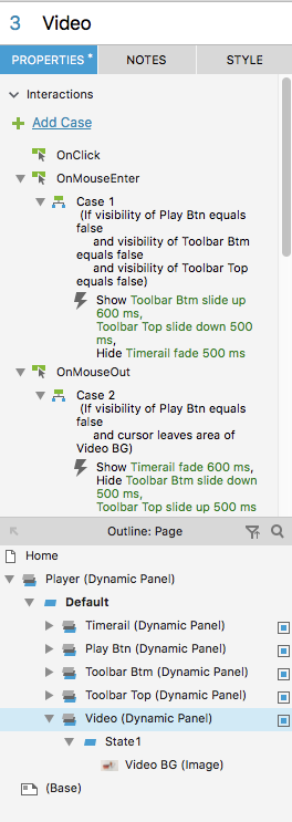

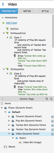

Thanks for the reply. I’ve tried using conditions, but still not quite working. With conditions it won’t activate the onMouseOut events at all. Doesn’t really seem to matter how I set up the condition. Here’s an image of the conditions I’ve got and the panel setup. Any other ideas? I feel like this should all just work and can’t quite place why it isn’t.
Without the .rp file this one in a but tricky to solve.
My guess is that your MouseOut never gets triggered before your mouse never gets out as there is a layer between your cursor and video that is your control panel. Try putting the mouseOut on the player control group or dynamic panel according to what you did.
