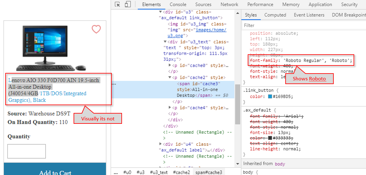

Hi, I have tried using Google Web fonts on my Axure RP file, but when i preview on browser text is shown in different font style. Please check the attached RP file and screenshot which shows in inspector “Roboto” but actually it appears differently.
please help me on this.

Hi!
You need to just use the URL alone: e.g.,
https://fonts.googleapis.com/css?family=Roboto:300,400,500,700
josephxbrick what does the numbers at the end mean? I don’t put numbers.
copy the link from google fonts exactly the way it is shown
“https://fonts.googleapis.com/css?family=Roboto&display=swap”
