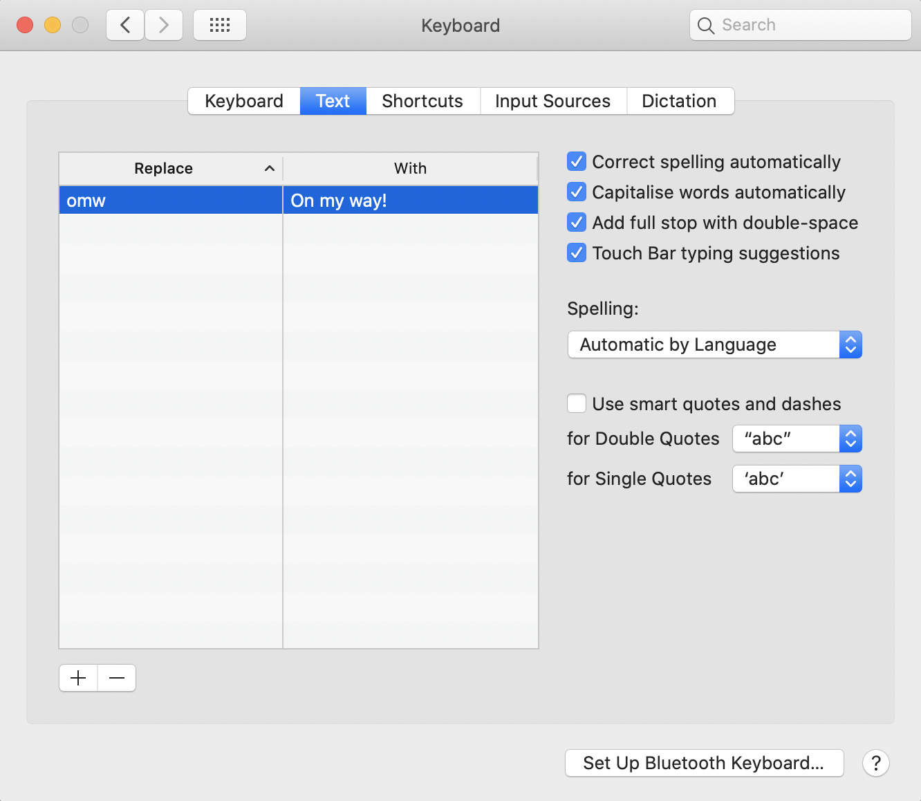

Thanks for pointing out the “smart” quotes issue! Now I only realized that the default settings for my machine’s keyboard have Smart Quotes & Dashes being turned on. This has created a problem each time when I enter the quote symbol, and it got “auto-corrected” unknowingly!
Should anyone ever encounter this issue, all you need to do is to go the Systems > Keyboard Settings> Text, unchecked the Smart Quote feature, if you are on a macOS device. (See above figure)
