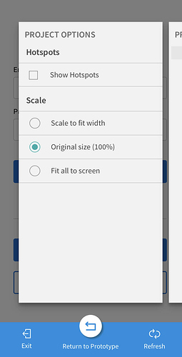

The only thing I can think of would be to open up your Project Options when viewing the prototype and test the scale options: Scale to fit width, Original Size, and Fit all to screen. What if you adjust the width in the Generate HTML window? Does the white margin grow or shrink depending on that width you set?
