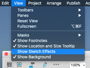

I ran into this same problem, and I’m not sure if this is an ideal or even sound solution, but it worked for me.
In the menu bar, uncheck “View > Show sketch effects”

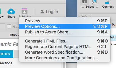

That fixes the view within Axure, now for preview & exports. Under the publish menu, select Preview Options
Then the blue “Configure” link in the upper right (would attach a screenshot but there’s a cap for new users)
Then under advanced check “Do not apply Sketch Effects”
Now all of these options for the preview should also be applied under HTML export, but it’s the same process to find the “Do not apply Sketch Effects” checkbox there.
