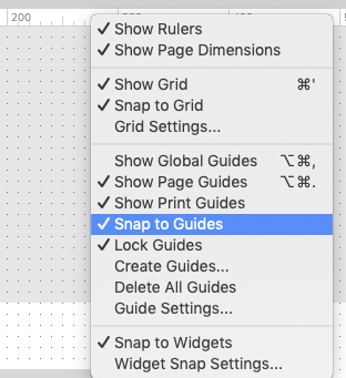

I would also recommend checking that “Snap to Guide” is toggled on! You can toggle guide snapping by navigating to “View > Rulers, Grid, and Guides > Snap to Guides” or by right-clicking on a blank space on the canvas or on the rulers.

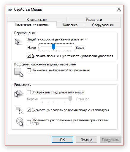

Are you using an external mouse, track pad, or tablet when dragging the cursor? If so, please tell me more about this device!
Please send a screenshot of the sensitivity and/or tracking settings for the mouse, trackpad, or tablet in use when this occurs.
- Windows 10
- 9.0.0.3636
- Im use external mouse logitech B100. I think what the mouse i have doesn’t matter at this case.

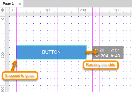

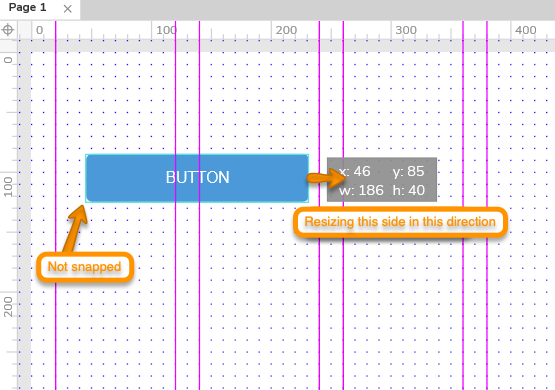

I wanted to let you know that I’ve been able to reproduce a similar issue when a widget has been moved to snap to a guide, and then the opposite side of the widget is resized. For example, guide snapping will work if the widget is not already snapped with a guide, as seen here:
However, if the widget has already been snapped to a guide, adjusting the other side of the widget will not allow for snapping, as seen here:
