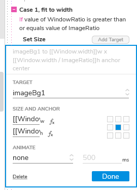

I use this logic to scale the image:
If WindowRatio is greater than or equal to ImageRatio, fit to width.
In the Window Resized event, I created a conditional case with logic: "If value of WindowRatio is greater than or equals value of ImageRatio, set the image size to:
[[Window.width]] x [[Window.width / ImageRatio]]
Else if WindowRatio is less than than ImageRatio, fit to height.
In the Window Resized event, a second “Else If” case sets the image size to:
[[Window.height * ImageRatio]] x [[Window.height]]
