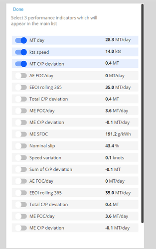

Hey, i have 18 dynamic panels, and i want to keep always 3 switches on.
If i swich on one swich, the other gets off, but it has always stay three on switches.
Is there any fast way Selection group?

The logic is simple. I have 3 KPI’s on my dashboard. and i go to edit dashboard view and change these three KPI’s. Maybe it is better not to show what is currently on, and don’t let user to confirm unless she selects three.
