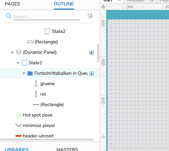

I cannot figure out, why a widget is suddenly being displayed at the top left of the page.
The widget is a small bar, that’s supposed to indicate the duration of the current track.
I use “set size”, to change the length of the bar. This action is repeated again and again, as long, as the track is on play.
So at first sight, everything seems to be working fine. But after a few seconds, the bar jumps to the top of the page, although the coordinates of the bar stay the same.
Can someone help me out or tell me another way do create an animated bar?

Right, when organizing the widgets in a DP, it doesn’t jump to a totally random position. That helps definitely.
However, the bar still moves a few pixels away from its initial position.

Hi @steven.wang I put it into a DP and it doesn’t work. I also tried move instead of set size, but still the same strange behaviour. I also use Chrome and have the newest build.
I managed to solve the problem by using a different logic to create the animation. I used a DP with a lot of states, each of which representing a state of the progress bar. Then I could set the DP to ‘next state’ to create the animation.
