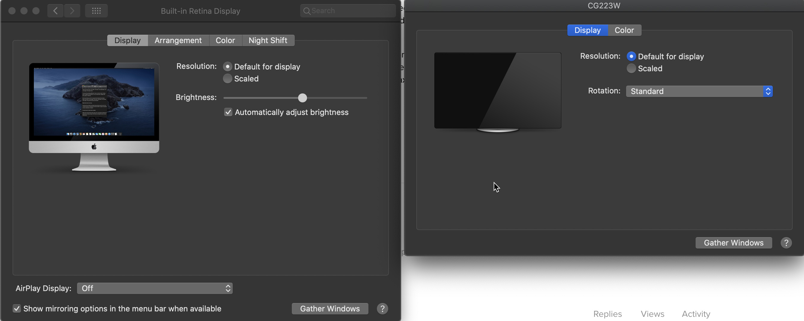

Thanks for the video @kckfm! That was very helpful for us. There’s a known issue that we’re looking into on our end where Macs with very high resolution monitors cause Axure RP to perform more slowly (even with small files), specifically if the resolution settings are higher and if the Axure RP window size is large and not in full screen mode. If you both wouldn’t mind, could you post screenshots of your current display settings for your monitors so that we can verify your settings? You should be able to see those in “System Preferences > Displays”.

Excellent, thank you for those! I’ll add those spec to the ticket we have filed. Meanwhile hopefully one of the workarounds works for you; using the green “+” button in the Axure RP title bar to go full screen should help to reduce lag a bit without you having to change your resolution on the 5k monitor.
@Alyssa_Axure i have standard Macbook Pro 15" 2019 retina display which is 2880x1800 i use it in scaled mode 1440x900, windowed mode. Also green plus sign did nothing for me either.
