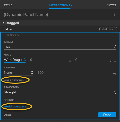

guys i want to ask
how do you make the banner / rectangle can be dragged left or right with drag restrictions?
in the project that I created, this banner is capable of being dragged to left, but without having the drag limit itself and disappears on the artboard
In your case, you’d want to specify a left boundary and a right boundary, with rules for when the movement can occur. It is not clear where you would like to limit the movement, but assuming you want to stop the banner movement when its left reaches the left edge of the screen area and when its right reaches the right edge of the screen area, the rules would be: left is less than 0 right is greater than [[Window.width]]
(…where [[Window.width]] is a built-in variable)
Since your initial position of the banner is at x=22, I will further assume you want to keep this as a “margin” for the left and the right. This would result in these boundaries: left is less than 22 right is greater than [[Window.width -22]]
