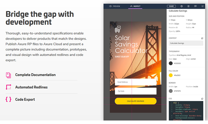

The tour on the new Axure homepage has the “Bridge the gap…” section. This looks interesting, but I can’t seem to find it after pushing a test file to AxCloud… Where can I find this feature?
Ah, got it, thanks for that. I was going to axshare.com where the program links to, not to app.axure.cloud. Not sure how I would have figured that out otherwise. Presumable Ax9 will be linking to the new location in the future.
