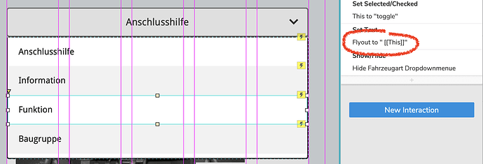

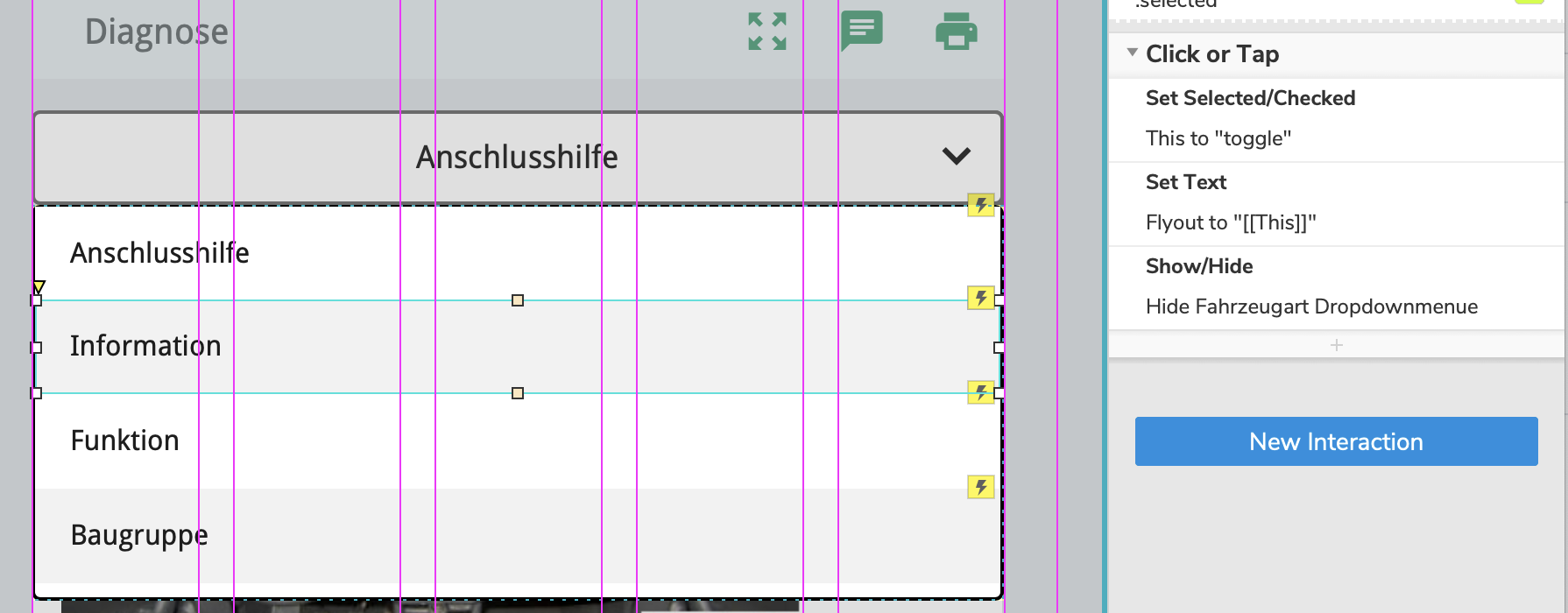

Hi Alyssa, I have an additional issue and don’t know whether it is the same bug or another one. I recognized that in the function code of some buttons, where on klick we put the text of a button into a flyout-menue-button, there is an additional space-letter. This may come from converting from ax 8 to 9. The strange thing is, with this additional space we get an error-message in the button where the text of the other should appear. But when I delete the space the functionality does not work at all (no text appears on the target button, but also no error message). Please see the enclosed images.
https://9ac2to.axshare.com/#id=xtpr5j&p=test_2&c=1
What do you think?
Ok, I figured out that the code [[This]] is wrong and has to be [[This.text]]. But beside this, with the space before the code, this is something that is still wrong, or?
Hi! Good catch! That’s correct–if you’re trying to set text on another widget to match the text of the current widget that is triggering the action, then you’ll want to use [[This.text]] rather than [[This]]. If I’m not mistaken, [[This]] means “the whole widget” instead of “just this widget’s text”, and presumably the space breaks this further. [[This.text]] should do what you want, either that or using a local variable to target your widget’s text should work!
