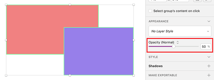

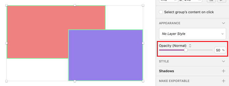

[ Edit ] Notice that Sketch gets it right in their UI: you can’t see through the top rectangle.
