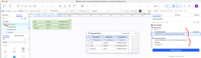

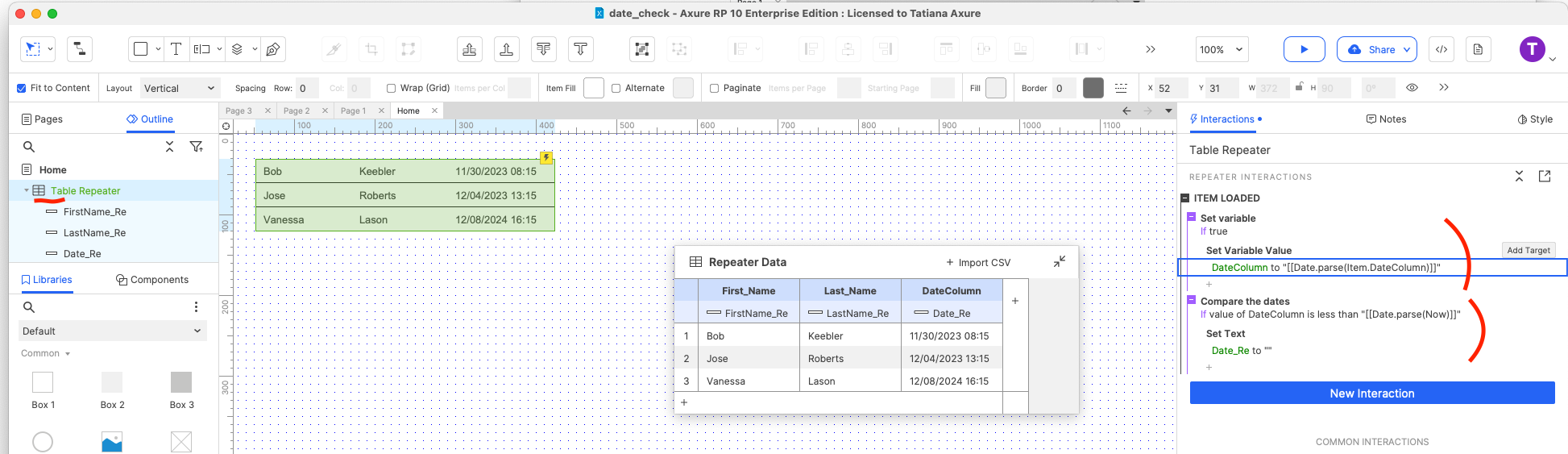

Hey Alan,
You can do this by using the Date.Parse() function. This function takes as a parameter the date string and returns the time difference as a number of milliseconds between January 1st 1970 and the date you use.
On the Item Loaded event of the repeater widget, set the variable value to [[Date.parse(Item.DateColumn)]]. Since the Item Loaded fires for every single row inside a repeater, you will get a one-dimensional data array with dates converted into numbers. Then, add a condition that compares the value of this variable with the [[Date.Parse(Now)]]. If it’s less than a current date, then use the “Set text” action to set the text on the date rectangle widget inside of the repeater to nothing. It should look like this:
date_check_AxureEdit.rp (60.4 KB)
I hope this helps!
If it doesn’t, please tell us a bit more about how the prototype should behave, and I will take a closer look!
