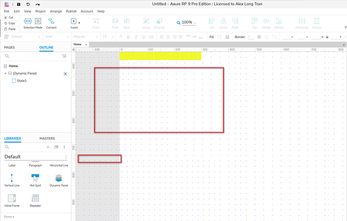

Yep, we have this one on file where the grid becomes distorted after dragging the canvas. I’ve added this post to that report as well, and we’ll hopefully see this resolved soon.
