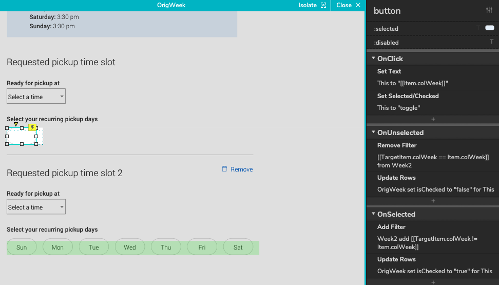

As for your comment about not doing any filtering, do you mean that I should remove the filter on the button:
And instead, use the Update Rows command or does this only apply to repeater 2?

It depends on what you want. If you want the date column (e.g., Sun) to disappear entirely, then you’d filter. But if you just want to disable it., then use the Update Rows command setting the isDisabled column, assuming you’ve set up the logic in the OnItemLoad interaction to display dates as disabled or enabled based on the isDisabled column.

If I select a day in repeater 1 (ex. Sun), repeater 2 would hide that day. This is a desirable outcome.
Now, if I unselect the day (ex. Sun) in repeater 1, how do I make that day (ex. Sun) appear again in repeater 2?
