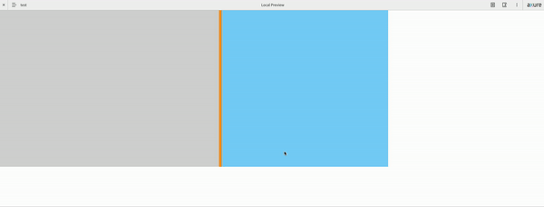

Trying to figure out the logic needed to implement a dual panel splitter/resizer control that will resize panels based on the location of the draggable resizer bar.
Test file attached.
Any help/assistance would be greatly appreciated.
Thank you!
test.rp (93.2 KB)
@caustin i’ve made the change in “test” page, hope it’s what you want
test.rp (93.8 KB)
@steven.wang thank you! Exactly the result I was looking for! I see the trick was to add in two set size interactions for each of the panels and then get the correct sizing logic for each panel interaction, etc. Simply genius! Great work! Thank you again for your help and expertise!
