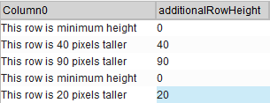

Here is sample output, whose authored height is 100.
Here are the values in the dataset that produced it:
If you know ahead of time how tall each row is going to be (e.g., a static prototype), you would just enter the values into the dataset ahead-of-time, like above.
If you are adding rows, just specify the additional height when you add it (or 0 if it’s at authored height).
