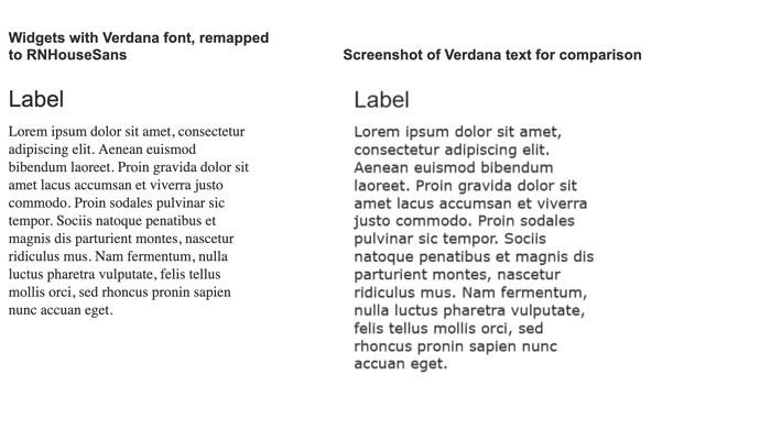

I’ve just tested your prototype and checked on your axshare link, and the font doesn’t display in my browser? Screenshot attached. How is it that you can see font but I see serif?
You are correct: the webfont did not actually work for me either. It showed the same serif font as in your screenshot–which looks like Times New Roman. I errantly just saw that the font had changed from Verdana and assumed it worked–not knowing what the RNHouseSans font actually looked like. (Duh… the “Sans” in the name should have clued me in that it would not have a serif style.)
