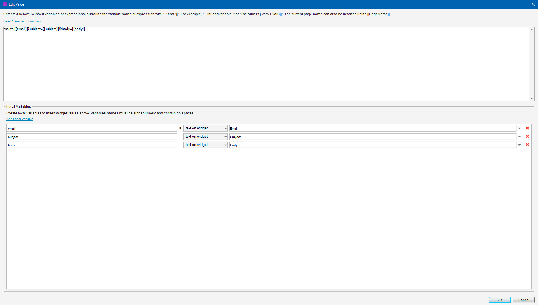

Saw your post and was attempting to set up a simple mailto: inside an Axure RP 8 prototype. That is a subject with a body.
However, I just can’t seem to figure out how to pass an Axure Variable (e.g. LVAR1). For example, all I get for the Subject in the e-mail is LVAR1 (e.g. subject=[[LVAR1]]).
I’ve determined that I can actually add several text fields to the “body” of the email. However, what would the code be between [[Body1]] and [[Body2]] to insert a couple of carriage returns?
