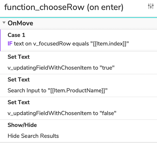

I added a keydown handler to the field, which increments/decrements the “variable” v_focusedRow on up-arrow/down-arrow. (I don’t use global variables if I don’t have; I use labels instead.) A listener in the repeater highlights the row whose Item.index matches v_focused row; this listener is triggered upon hitting the up/down arrows.
There is a second listener (triggered by pressing enter in the field) that updates the field with the row that has “focus.”

@josephxbrick Could you help me understand what is the reasoning behind setting the variables to true and later false before and after populating the text field respectively? What exactly happens during those times when the variable values change? Can’t we just set it to false and leave it alone?
Hi!
The reason is this: the filter is updated on the Text Changed event. That event is not only fired when the user types in the field; it is also triggered when the text of the field is changed through code. Setting this variable to true just before setting the text of the field and to false again after setting its text prevents this filtering from happening, due to the condition I added to the Text Changed event.
Hitting return causes one of the listeners to set the text of the field to the “focused” value, which in turn re-filters the repeater. This was causing a bug, which you will see if you remove the “set to true” command.
I didn’t want to spend the time to debug what exactly was happening, but I figured that reapplying the filter was somehow “short-circuiting” the listener’s trip through all the rows, so I added this code. There is probably a less hacky solution out there, but there is no reason to refilter the repeater here anyhow, since it’s hidden.
