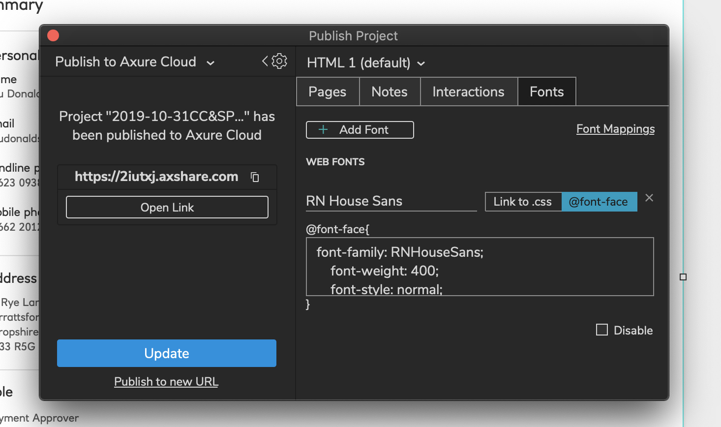

Hi, I have been trying to install Gobold into Axure with no luck. It has been since last Tuesday and I am running out of time!
I tried add this in the @font-face tab… XXX represents http because I can’t paste links in here.
This shows up correct on my mobile device but not an another computer(that is not my dev computer)
As long as your font mapping and CSS or @font-face URLs are correct (and you have internet and access to the server hosting the web font) it should work via Preview, unless you are trying to preview an Axure Library file.
This thread might help you…
You can always send an email to support@axure.com with your details. They have been very good and quick to respond in my experience.
I could not get the fonts hosted on transamerica site to work either. You might have better luck with a dedicated webfont hosting site that has the Gobold font.
I created an RP8 version of my demo file, and added a page with the Oswald font from Google Fonts as an additional example. It’s pretty similar to the Gobold font.
