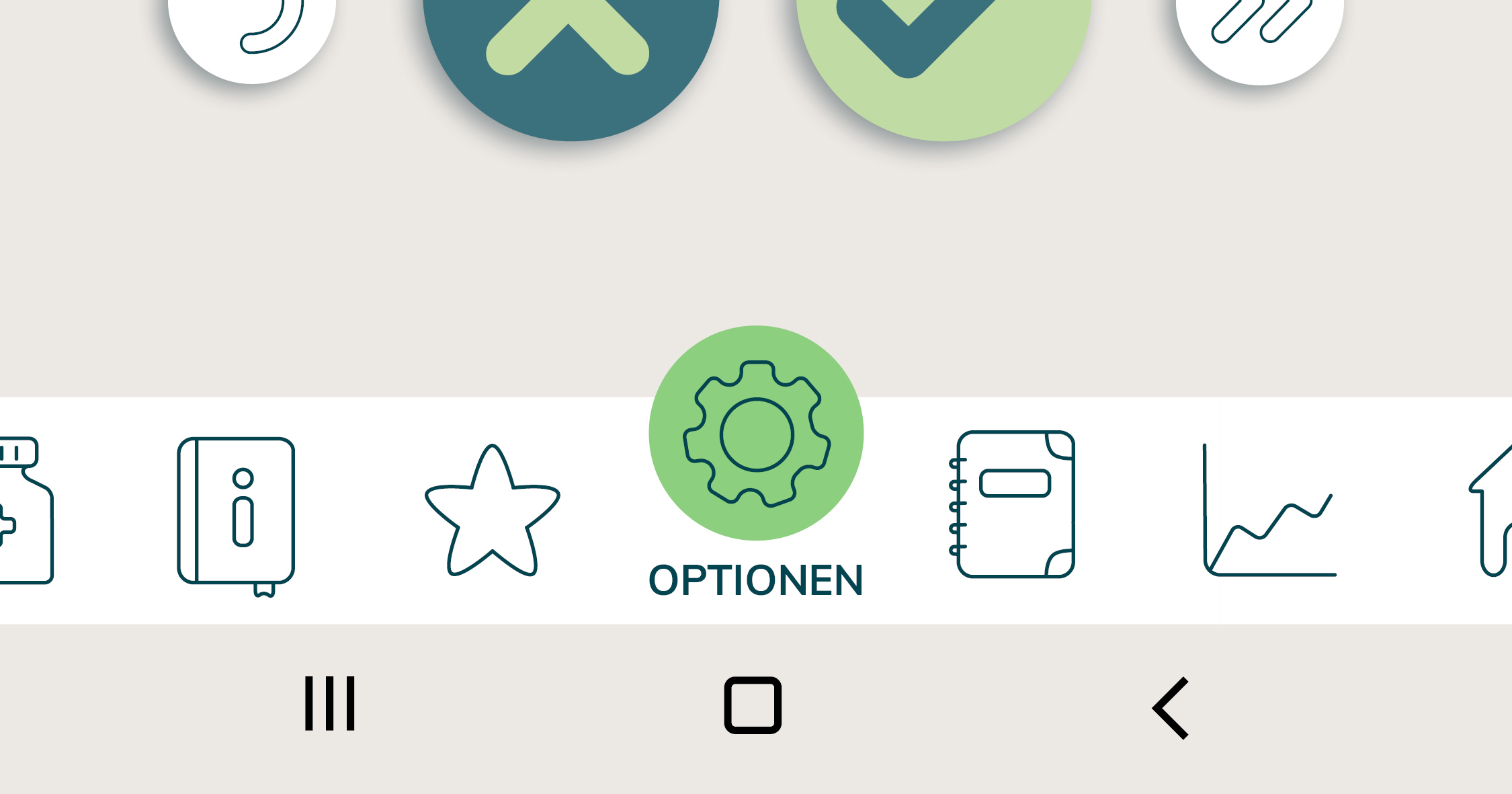

it is possible to create a horizontally scrollable tab bar for a smartphone in Axure? The menu items should not have start and end points but should loop. The selected menu item is in the middle and the text should appear below it. I look forward to your answers and thank you in advance. Here are some pictures for better understanding.
Yes, you could do this with a Dynamic Panel, set to loop through its states. I think you can use animations to transition between different dynamic panel states, but you might not be able to do as detailed animations as your visual implies.
Actually if you’re allowing users to tap on any item in the menu (rather than going through the items sequentially) then you don’t need to loop.
You would create your navigation bar with your default ‘home’ item in the centre, then create empty states for each of the other items in the nav bar. I would then add a click/tap interaction to each item that sets the dynamic panel to the appropriate state. Then I would copy your first nav bar into each of the dynamic panel states and move the buttons around/restyle everything. Then the user should be able to tap each icon and have it activate the correct state.
