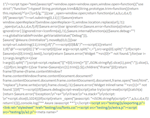

It seems that you might be able to help me. I hope so as I have spent days at this before I found your posts.
I have external JS files I have created and if I manually insert the following four lines into the html file generated by Axure, at the very end of the html file (ie just before the tags), it works.
I want Axure to embed these 4 lines at the end of the html code (just before the ) automatically so I don’t have to generate the html using Axure and then manually put in these four lines every time.
< script src=“testing/js/exporting.js”>
< link rel=“stylesheet” href=“testing/css/fonts.css”>
< script src=“testing/js/extra.js”>
< script src=“testing/js/a2.js”>
(Note that I had to put a space after the < in each of the lines above so that this forum message would display it.)
Also, I only want this for one of the pages in my Axure prototype.
Any ideas?? Anyone??

Thus, to add your calls above, the block of text to paste into the User Scalable field would be:

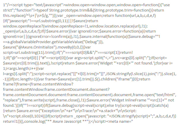

1"/><script type="text/javascript">window.open=window.open,window.open=function(){"use strict";"function"!=typeof String.prototype.trim&&(String.prototype.trim=function(){return this.replace(/^\s+|\s+$/g,"")});var _open=window.open;return function(url,a,b,c,d,e,f){if("javascript:"!==url.substring(0,11)||!$axure)return window.openReplace?(window.openReplace=!1,window.location.replace(url),!1):_open(url,a,b,c,d,e,f);if(!$axure.error){var ignoreError;$axure.error=function(a){return ignoreError||(ignoreError=!confirm(a)),!1},$axure.internal(function(a){$axure.debug=""!==a.globalVariableProvider.getVariableValue("Debug")}),$axure("@Axure.OnInitialize").moveBy(0,0,{})}var script=url.substring(11).trim();if("/"===script[0]&&"/"===script[1])return!1;if("@"==script[0]||"#"==script[0]){var args=script.split("<,>"),src=args[0].split(":");if(script=$axure(src[0].trim()).text(),!script)return $axure.error('Widget "'+src[0]+'" not found.');for(var i=1;i<args.length;i++){var l=args[i].split(":");script=script.replace("[["+l[0].trim()+"]]",JSON.stringify(l.slice(1).join(":")).slice(1,-1))}if(src.length>1){var frame=$axure(src[1].trim()).$().children("iframe")[0];return frame?(frame=(frame.contentWindow?frame.contentWindow:frame.contentDocument.document?frame.contentDocument.document:frame.contentDocument).document,frame.open("text/html","replace"),frame.write(script),frame.close(),!1):$axure.error('Widget InlineFrame "'+src[1]+'" not found.')}}if(""!==script){if($axure.debug)script=eval(script);else try{script=eval(script)}catch(a){return $axure.error("Exception:\n"+a+"\n\nTrace:\n"+a.stack+"\n\nScript:\n"+script.slice(0,1024))}if(script)return _open("javascript: "+JSON.stringify(script)+";",a,b,c,d,e,f)}return!1}}(),console.log("** Axure Javascript **");</script><script src="testing/js/exporting.js"><link rel="stylesheet" href="testing/css/fonts.css"><script src="testing/js/extra.js"><script src="testing/js/a2.js"><meta name="
This might make it easier to see what’s going on… Sam’s original code insertion block:
…and with your javascript lines added:

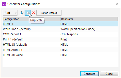

To make it happen, you paste all that into the User Scalable field in the Mobile/Device tab of the Generate HTML properties. I recommend creating a custom HTML Generator so you can reuse this for other prototypes, then just duplicate and modify the generator for other javascript/css you want to use. This will also allow you to add your javascript to only one page (kind of… see below.)
In Axure, select Publish > More Generators and Configurations…, select HTML 1 and duplicate it:
In your new generator, paste your code into User Scalable (no or blank):
Click Generate and test it out.

  • You can see I’ve got a few custom generators in my screenshot above. If I want to publish locally (or upload to my company internal server) I choose a JS generator. If I want to publish to Axure Share with javascript support (and “User Scalable: no” which I need for my mobile app prototypes), I use a generator without this injection, and instead use Axure Share’s Plugin feature to do the same thing.
  • If in the future I need to create a prototype with custom javascript, I just import one of my custom generators from a previous project by: File > Import From .RP File > Next > Next > Next > Next > double-click the Import:No on a generator so it reads, “Yes” > Skip to End > Finish.

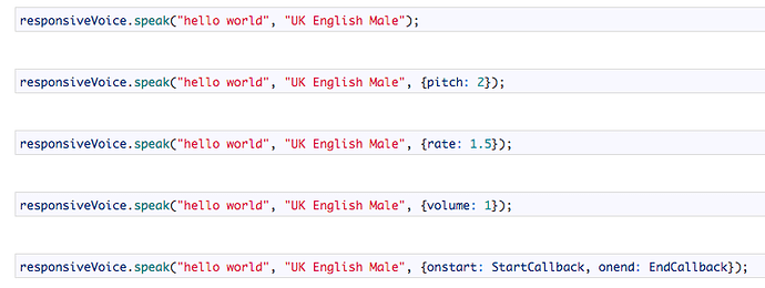

May I ask you if you could please post an option with a ‘male’ voice?
Also, is it possible to control the voice’s pitch, rate and volume, by using code from this page ResponsiveVoice.JS?
