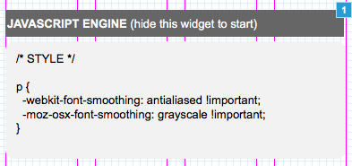

These are the steps I took:
Download the first item (‘AxQuery and Javascript 1.03.rp’) from the top post on this thread
Open ‘Examples’ and copy the Javascript engine section to the footer of my prototype (so it appears everywhere, rather than copying to every page)
Remove the Javascript box and edit the style box, so I end up with this in the footer:
Finally, in the footer on page load I hide the Javascript Engine:
Very hacky but this works for me as a way to insert custom CSS locally - in this case, for font smoothing.
