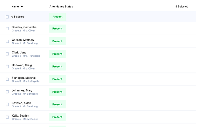

The mechanism in AXURE is that when you make any changes to any column data in a row, the data of all rows in the repeater will be reloaded. There is no way to change this behavior.
For example, if you select any element in a row, the reload will unselect it.
If you want to maintain the selection of an element after changing the data, you can control the selection state with data. For instance, you can add a column in the repeater’s data table to control the selection status.
You can refer to this case to control the comlunm states. More tutorial contents.
