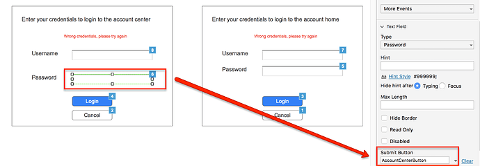

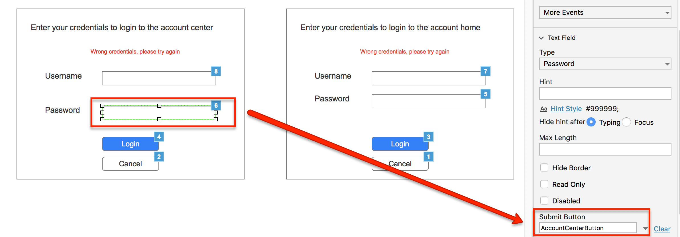

Hi rzhang,
The reason why the AccountCenterButton works as expected, but the accountHomeButton does not, is because the password text field in the Account Center group had a designated Submit Button (AccountCenterButton), while the password text field in the Account Home group did not:
That is, the OnFocus was not working/firing for either, but you were seeing the expected behavior for the Account Center group only because it had a targeted Submit Button. To get the intended behavior, Anand’s suggestion of moving the OnFocus interaction to the OnKeyDown event instead should help, or assigning a Submit Button to the password text field in the Account Home group should help as well.
