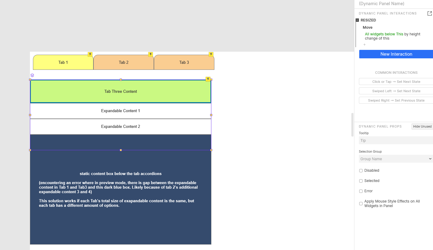

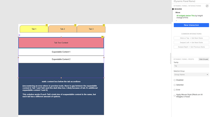

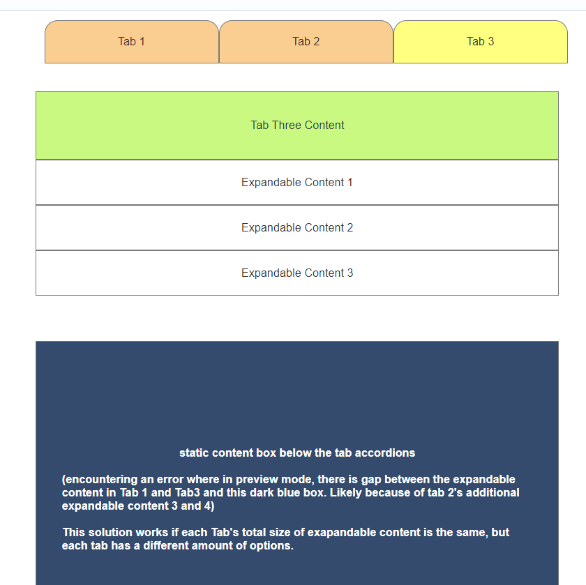

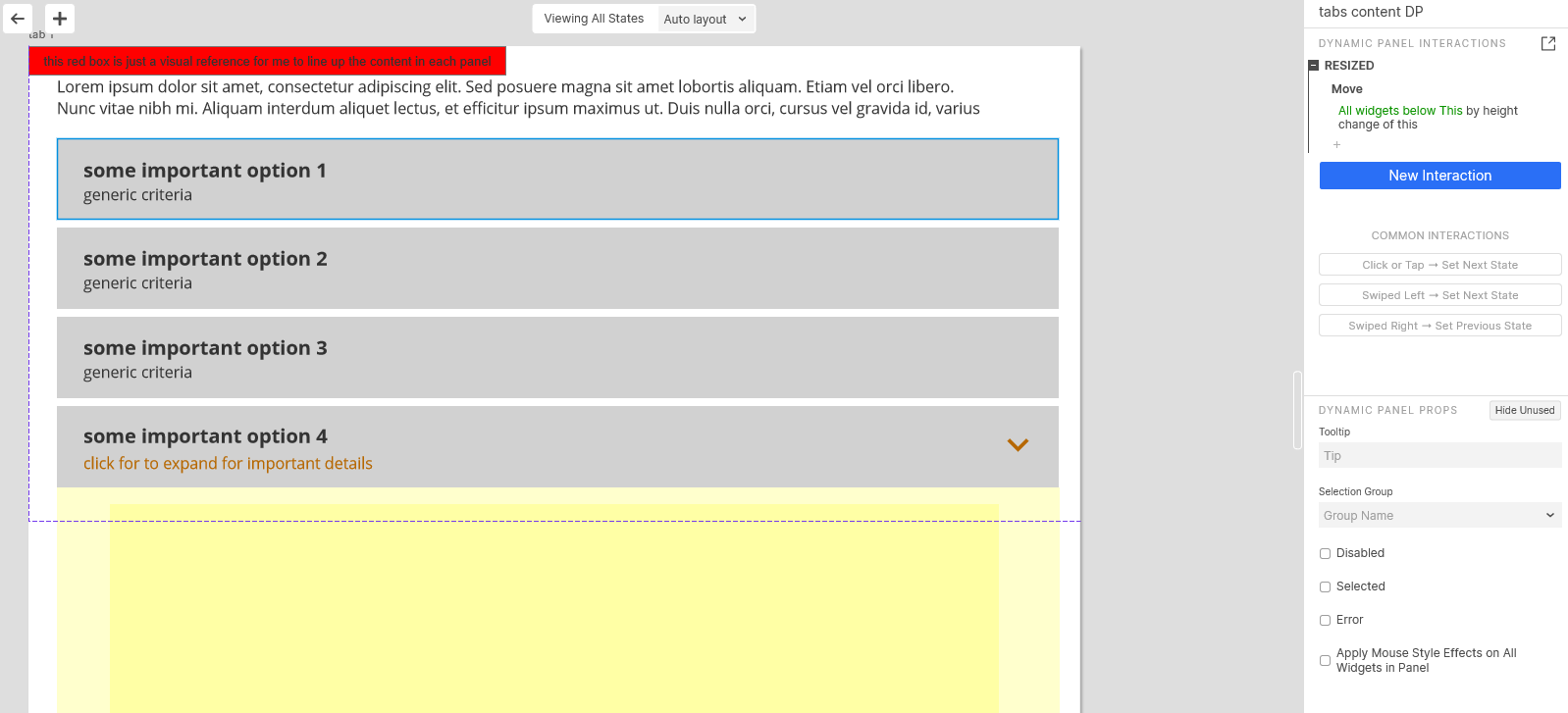

Hey Ben! Thanks for the accordion example. I’ve tried the ‘resized’ function you provided and it somewhat works as your example had the same amount of expandable content under each tab.
My project is more complicated as each tab has a different amount of content, so the space it takes to expand isn’t the same under each one. In preview mode, it shows the inconsistent spacing pending on which options I have open within each tab before I switch to different ones.

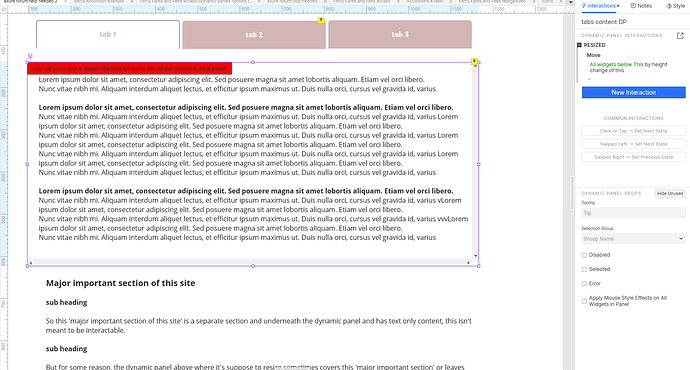

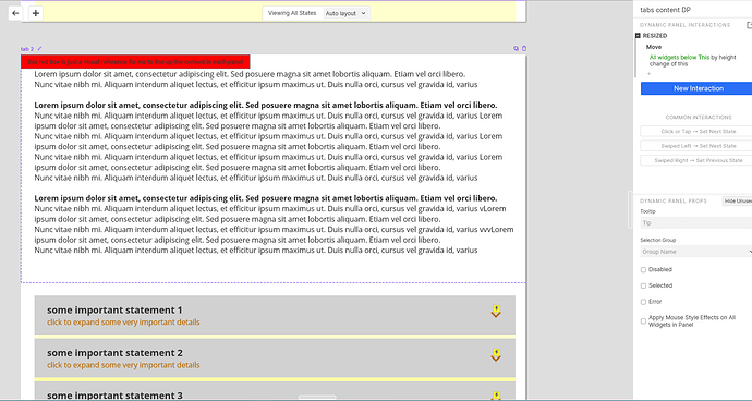

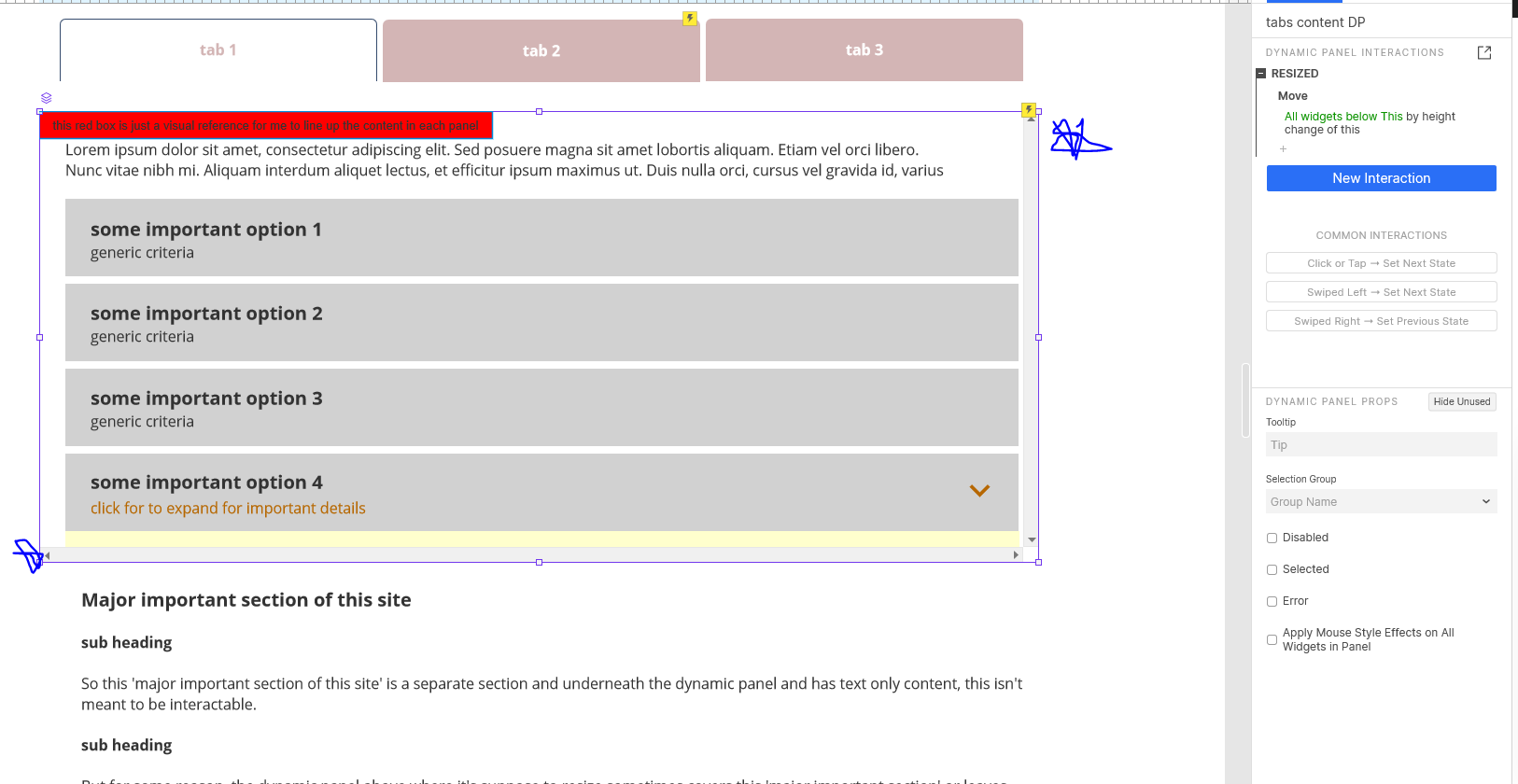

In my actual project, the dynamic panel seems to be restricted to one size of each panel, I’m not sure why it is that way, as the example I edited with yours doesn’t have that problem. In my project, its added arrows where you can expand and scroll to read that content within but it doesn’t push/pull the content outside the dynamic panel. (uploaded relevant pics of both your example I edited and the actual project of mine)
