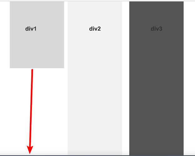

Page Loaded can not resize the height of dynamic panel to adjust the height of window
You can see the picture above. I have set Page Loaded to resize the height of the dynamic panel to the height of the window. But it did not work. Is this a bug?

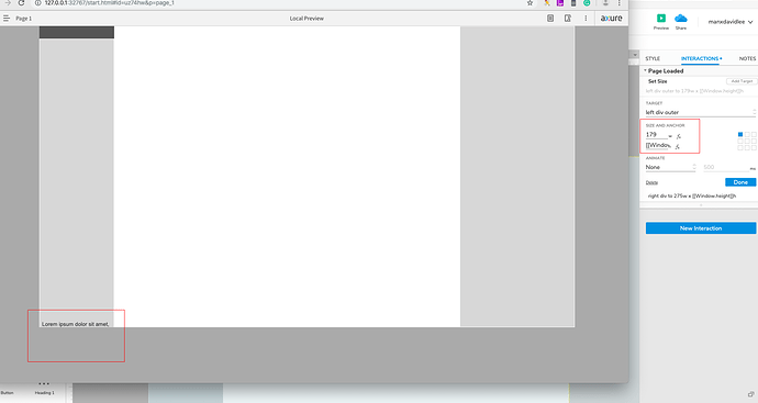

Not clear what your expectations are… how should the page look? Should the “left div outer” widget be positioned at the top of the page/window, or is it pinned to the bottom? …Maybe try setting the anchor point for the Set Size action to the bottom-left instead of top-left?

Please download the test.RP above. I want to set the DP div1 to equal to the height of windows when the page loaded. And I have set the page loaded event. But I find that it doesn’t work to the DP div1. So could you help me to correct this? Many thanks.
Thanks for the .rp file. I can see the issue now… So, it turns out the “div1” dynamic panel actually does get sized to the widow height, but you never change the size of the contents in it, and the dynamic panel has a default transparent fill, so you just can’t see that it has been resized.
To demonstrate this, I set the fill for div1 to yellow and made no other changes to Page 1. Have a look:
