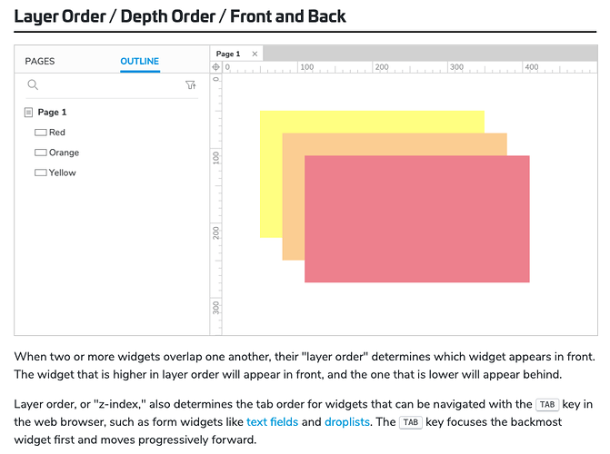

Widgets that are higher up in the outline on the left are higher in the Z index. So you just need to put things in the order which you would like them to overlap.

Sorry, but I’m back This is in response to the overlapping error text issue (should have looked a bit closer, my bad). The problem is I need to have them ordered the opposite way so that when I hit tab from the password field it will focus in the re-enter password field. It seems to be either one or the other.
Ah, I see. There’s three ways to show/hide a dynamic panel. The first is to have a default state with nothing in it. The second way is to hide the dynamic panel, but then tick the box that says ‘show if hidden’ when you change the panel’s state.
The third way is to hide the dynamic panel, change the dynamic panel’s state, then have a separate action to show the panel. This will then allow you to use the ‘bring to front’ option, making your layering order irrelevant.
