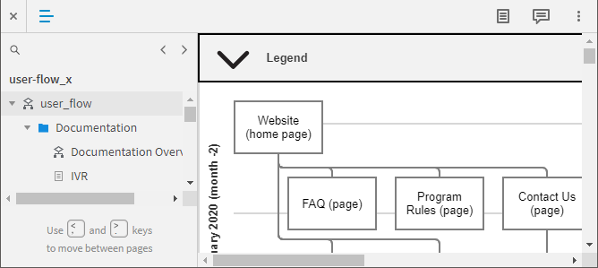

I am having the same issue now, not sure exactly when it started occurring, so I’m unsure if it’s due to a version issue, corrupt project file, or other cause.
To summarize…
Publish > Preview:
Publish > Publish to Axure Cloud…
