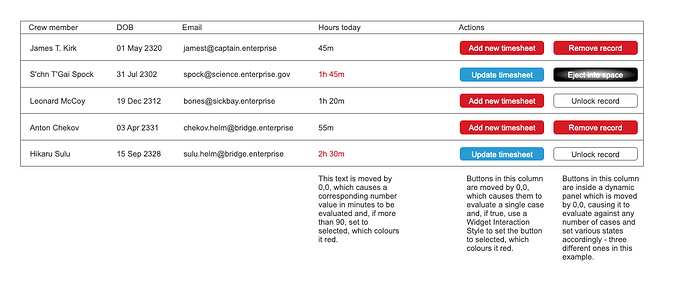

In the example, some text lines are set as they normally would be, using ‘Set Text’ interactions. However, the two columns of buttons are moved by 0,0.
Then, on those two buttons, they self-evaluate by using conditions on the widgets themselves to check the values in the appropriate repeater columns. The first column uses widget styles to do this and the second uses dynamic panels (to be able to handle multiple possible states).

I’m not sure what you’re asking, but the two methods shown in my example file can be adapted to pretty much anything. Unfortunately you can’t directly set fill colours etc - you need to use either widget interaction styles (which are limited in number) or dynamic panels (which can be a pain to keep consistent with each other).
If you’re evaluating time data, you’d need to store that as a number so you can use ‘less than’ and ‘greater than’ evaluations. I’d suggest storing it in minutes. There are maths functions you can use to convert minutes to hours (as in, 90 becomes 1h 30m) but if it is just a static demo table and you won’t be updating values, I generally just use another repeater column to store the text version.

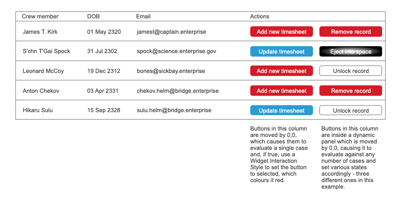

Actually on re-read I think I’ve understood. Here’s an updated version:
SelfEvaluatingRepeaterv2.rp (77.9 KB)
This is using the simpler interaction styles version of this trick. If you needed multiple text colours, you’d need to make that text widget into a dynamic panel and then make sure that your set text action targeted all of the potential states of the panel and updated text in all three (or more) of them. It would be great if Axure featured a ‘Set Style’ interaction, because this way of doing things is very fiddly and fragile, but I’m afraid it doesn’t currently.
