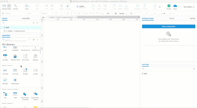

I create a Dynamic panel of the repeater (and other widgets - that does not make any difference)
I duplicate state1 (that has the repeater inside)
I open state 2 - repeater now is nulled. no values even though all interactions defined.
when I try to “reconnect” and load the values - I did not succeed.
Hi, this sure sound like a bug - on V8 I was able to duplicate a DP state that includes a repeater successfully - all the repeater data was duplicated and appeared on the new state as expected
Thanks! BTW, if you copy & paste the repeater from one state to another - it works.
So it happens only when duplicate a state that includes the repeater.
