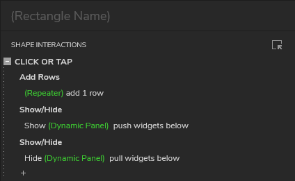

This is because your repeater is in a dynamic panel, and when “Add User/Group” is clicked, you add a row to the repeater, show the dynamic panel and then hide that dynamic panel:
Maybe your intent was to first hide and then show the dynamic panel, using the push/pull option in order to move widgets below it. Makes sense, but unfortunately that method is not reliable in Axure, especially with dynamic content (the size of your repeater as you add/remove rows.) I’ve found it is better to make the dynamic panel “Fit to content” (which you have set) and then use its Resized event to control the position of widgets below it, using a relative pointer to [[This.bottom]].

- I removed the Hide event from the “Add User/Group” button, and the repeater is visible when you add rows.
