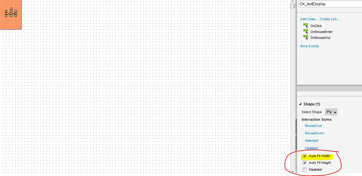

Hello Jane, the link is dead. Could you repost how to make the repeater automatically auto-fits to its text please?
Sébastien
Hi OrangeAX,
Ah, it looks like that archived link mainly included a discussion surrounding autofit in general, rather than providing any specific examples. In case you’re looking for more ideas on how you might accomplish this, the following posts include some sample files that can help as you start:
https://forum.axure.com/t/auto-fit-height-width-repeater/28605/8
