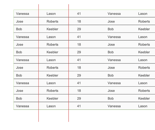

Hi everyone, I am trying to add vertical borders in a repeater table without success. Does anyone know how to do this? I have attached an image for ref of red vertical lines. Thanks

Are you wanting to add the colored borders dynamically, or will that column always have left/right red borders?
The easiest way is to hide all of the borders for each “cell” inside the table. The set the second cell to show the left and right border and set the color.
Add another widget behind all of the cells in a row and use that widget for the bottom border. If you want, you can set the repeater to hide the “border widget” for the last item in the list.
Style_borders.rp (55.0 KB)
