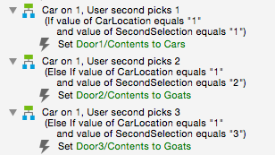

My second choice will reveal either a goat or a car, but this time the logic is a bit more straightforward, with 9 total cases:
And so on for each combination of SecondSelection and CarLocation.

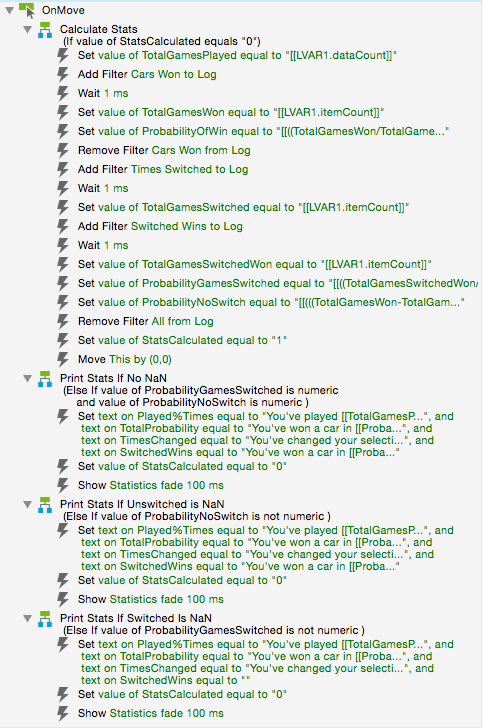

Whenever you finish a round and the “You won a ___” message appears, the relevant data is added to a new row in the repeater and another hot spot is moved. This one, appropriately called “Stats Generator”, both calculates the statistics and prints them:
It uses the Repeater.dataCount method to get the total number of rows in the repeater—that’s the number of rounds played so far.
It sets a filter “Cars Won”, [[TargetItem.Prize == ‘Car’]], to limit the repeater to just the rounds in which a car has been won, and then uses the Repeater.itemCount method to grab the number of rows left—this is the total number of cars won over the course of play. You’ll notice that there’s a “Wait 1 ms” action here—that forces Axure RP to execute the steps sequentially. Without it, Axure RP will try to apply the filter at the same time that it performs .itemCount, which will return unexpected values.
It removes the car filter and calculates the total win percentage thus far: ((TotalGamesWon/TotalGamesPlayed) * 100).toFixed(0), which gives us a nice, clean integer between 0 and 100.
It sets a filter “Times Switched”, [[TargetItem.FirstSelection != TargetItem.SecondSelection]], to give us just the games in which the selection was changed, and then repeats the above process on this smaller set of data to give us the total numbers of games with and without a switch, and the total numbers of games won with and without a switch.
The widget is moved again, causing it advance to a few cases that allow it to print legible statistics while avoiding printing the results of a divide-by-zero operation, which would display as “NaN’”—“not a number”.
