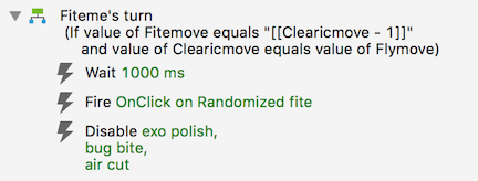

To ensure that all the monsters wait their turn to attack, there are monster move global variables that start at zero. When the user chooses an attack, a move is added to their monster’s move variable.The next monster in line is inclined to take their turn if the monsters before them have the same number of moves, and the number of moves for that particular monster is one less than the move used by the previous monster in the turn rotation.
When all four monsters have had a turn and have the same move count, the user is able to choose their next move, and the turns begin again. When an enemy monster has fainted, their move count is made to equal the user monster’s move count, so that the fainted monsters move is effectively skipped over.

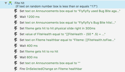

When Flyflyfly’s Bug Bite hits Fiteme, the global variable FiteHealth is set to [[FiteHealth - (50 * .5) + ((FiteHealth - (50 * .5)) * (FiteDef / 100))]].
Bug Bite’s damage is cut in half because of Fiteme’s Fighting type advantage (50 * .5) and then Fiteme’s health gets a bonus amount added if the defense variable is greater than 0.
