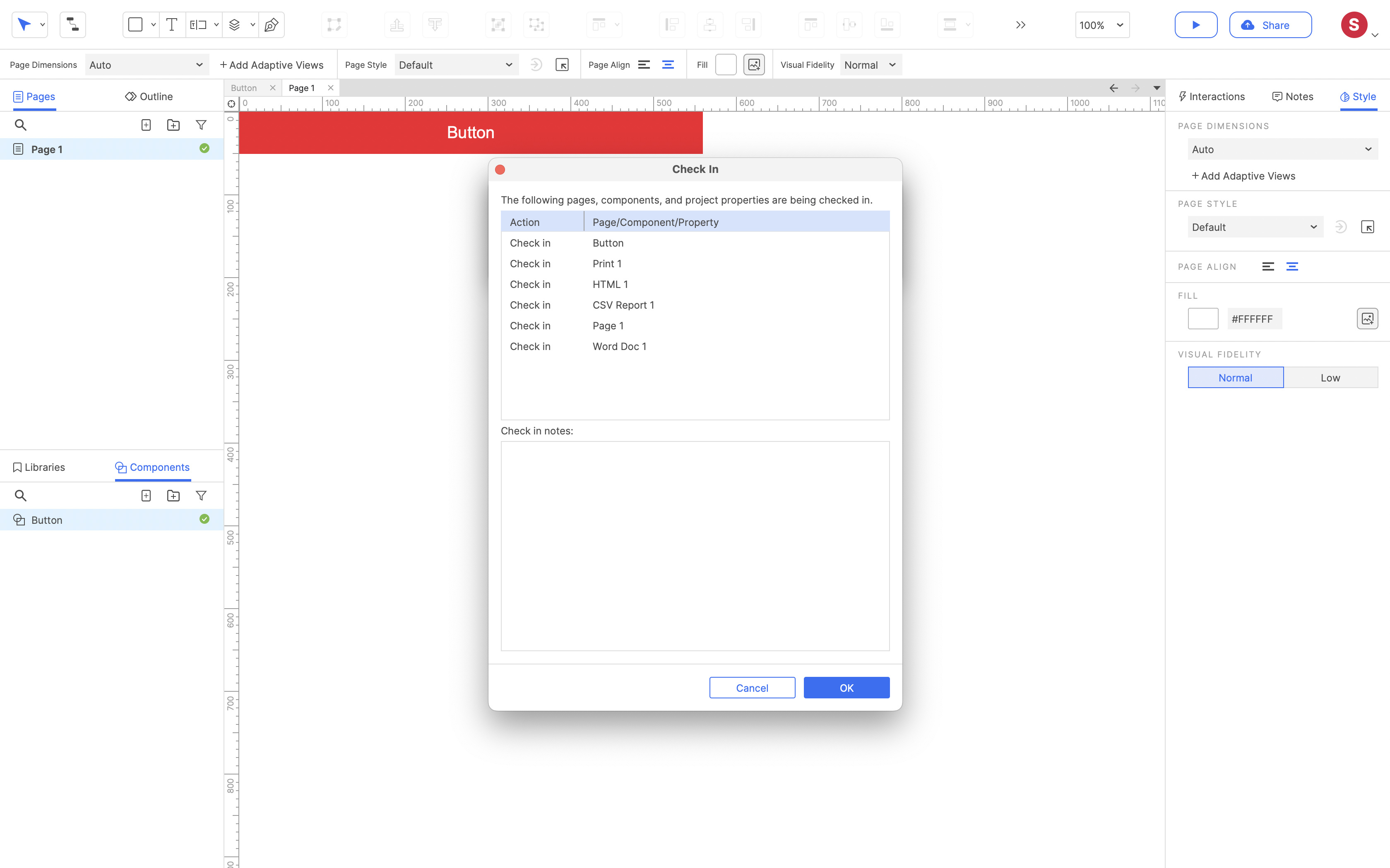

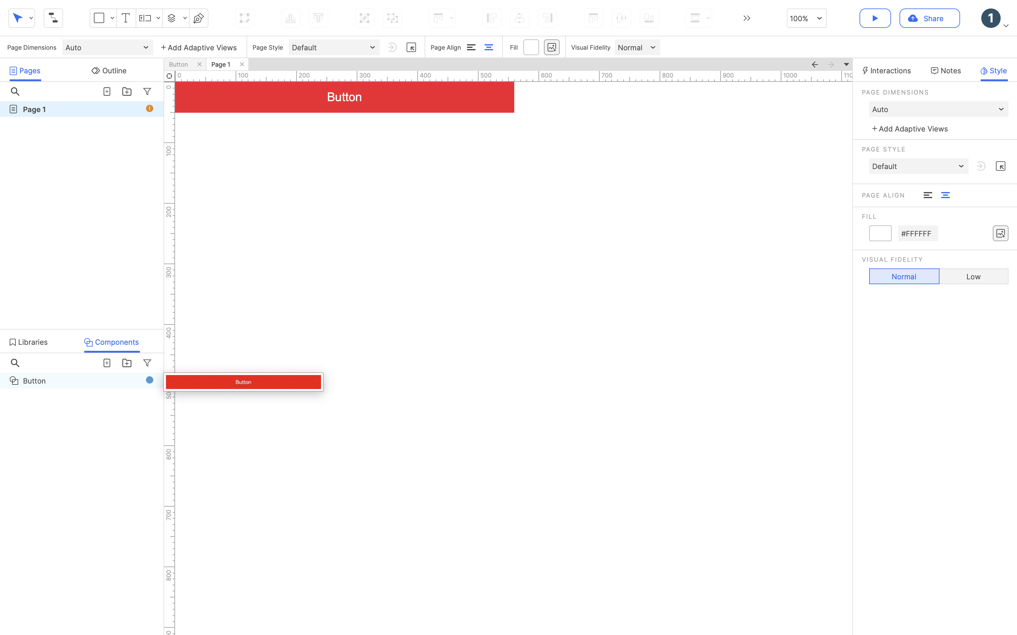

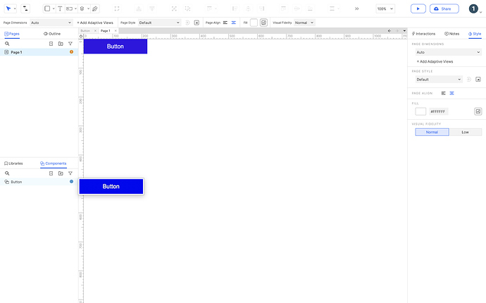

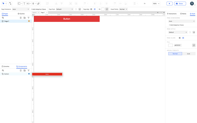

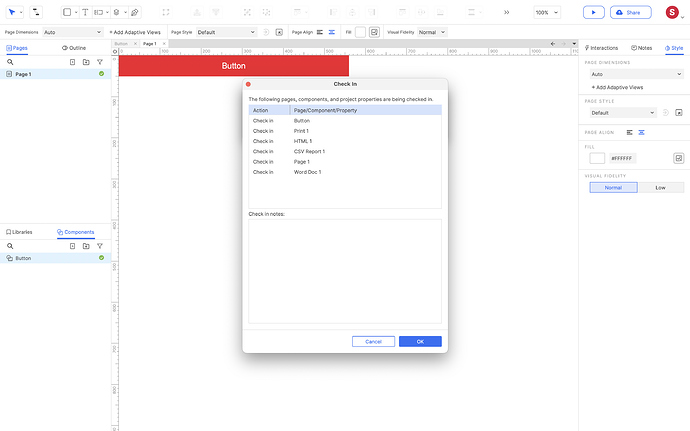

Firstly, I created a Team project(not a Team library) and saved two copies, one for me and one for my colleague. This is the interface for my account, and you can see that Page 1 is an instance of Button Component

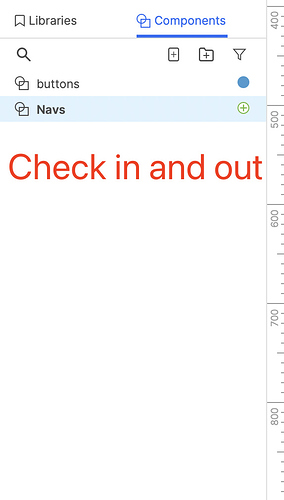

You will create all widgets into the component pane (organized through folders). Then, by updating it through Team Project, maintenance of this library can be achieved.
