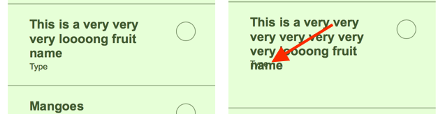

When the text length is long in a repeater, adjust the widgets in the repeater item by moving the widgets below the text to avoid overlapping(below screenshot).

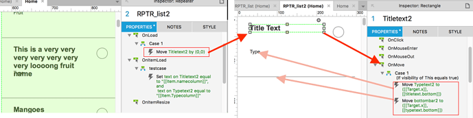

Method 1:
On Item Load: Load the item values from repeater columns > Wait > Move other widgets below the long text. This seems to work well in Axure 8 Canvas(see below screenshot) but didn’t work in the browser, so I have tried another method.
Method 2: (Based on the explorations by @mbc66 )
On Load: Move the long text in the repeater item by (0,0) and then trigger an OnMove event for the long text widget inside the repeater item. So, when the OnMove event is triggered, we move other widgets below the long text. This method worked well in the browser.

Issue#1: For method 1, why is there a difference between how it is rendered on Canvas vs Browser ??
