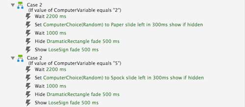

The issue that I encountered when I started adding the timing of the animations was that the computer’s choice kept showing up prematurely. It is supposed to wait to show until after the “VS” sign, however almost as soon as the player picked a choice, the computer’s choice was already sliding in. I thought to resolve this by setting the Math.Random action down to the bottom of the first case, but this resulted in the computer’s variable not being set at all. Because of this, I had to move the “Math.Random” function back to the top.
You’ll notice that at the start of each condition that evaluates the ComputerVariable, there is a 2200ms wait; this allows enough time for animations in Case 1 on each button to execute the “Hide”, “Show”, and “is Selected” animations in order before the ComputerChoice kicks in and shows the dynamic panel state corresponding to the weapon chosen by the computer.
The math that determined the 2200 ms wait at the start of Cases 2-4 is as follows:
500 ms to show the “DramaticRectangle” (the blue background that covers the game picture) and hide the “PlayerChoice” and “ComputerChoice(Random)” dynamic panels.
1000 ms wait to build drama (drumroll please)
800 ms wait between the setting of the “PlayerChoice” panel state and the setting of the DramaticRectangle’s “is Selected” style to “true”.
2300 ms
I shaved off 100 ms from the wait time (hence 2200 ms) to speed things up ever so slightly, since the player already has enough drama at the start of the animation.
The moral of this story is this; if you set the value of a variable to a certain value, and have a case that sets off some actions based on the value of that variable (even if there are other actions to complete between the first and second cases), the actions in the following case will begin to fire off once their condition is met, regardless of whether the first case is complete. For this reason, you’ll want to establish a “wait” to make sure that all of your animations complete in the first case. Otherwise the actions will try to fire in a (seemingly) simultaneous manner.
