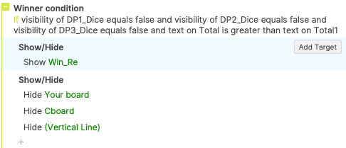

When there are no dice left to click on, the game’s outcomes are shown.

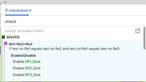

One of the challenges I encountered was adding more conditions that would not contradict each other in the same event. So, to fix this problem, I used several tricks. First, I added three buttons and programmed them to disappear by the end of their action. Also, I added a couple of hidden rectangles on the canvas. I connected them via a Move Action on the onClick event for every button and set the conditions for the enablement of every dice on the Player board.
