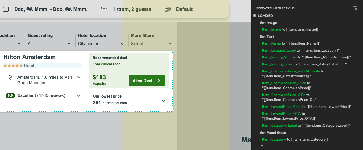

Hi,
I have a repeater with a template containing a dynamic panel Item_Category. The dynamic panel has 4 states (AA, 3 stars, 4 stars, 5 stars).
I have a repeater that contains 5 rows (ie. 5 items) and the columns Item_Category & Item_CategoryLabel.
I am trying to set the dynamic panel by calling the Item_Category as the value however this does not return the desired behaviour.

Iâve tried the second option but nothing seems to change;
Iâve attached the original file with my implementation as a reference. Price_configuration_CategoryShare.rp (1.6 MB)
Is there something wrong with the way the interactions are set up? I was looking primarily at the dynamic panel implementation.
You had all your load interactions on the âRepeater Loadedâ rather than the âItem Loadedâ interaction. This means it will only evaluate once and then do the same thing for every row. Item Loaded goes line by line and evaluates each row individually. In general you would use âRepeater Loadedâ for things like resizing or moving pagination around etc.
Amazing! Completely missed that. Thank you so much that was super useful.
