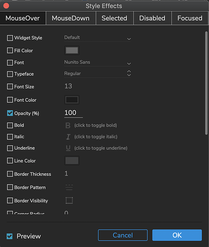

To avoid the blue rectangle that appears around your radio button when it gets focus, be sure to assign the radio button a focus “style effect,” which you can do through right-click. (I simply set its opacity to 100 for the focus style event, which was already its opacity, so there was no visual change but more importantly there was no blue rectangle…)
