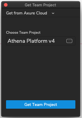

Hey there. My team and I just switched to Axure 9. We’ve exported our Axure 8 team project as an rp file, opened it and saved it with Axure 9 and then imported it as a team file again in Axure 9…
The team file is working for the team member who has created it but when other team members try to fetch it from the cloud (“get Team project”), the loading freezes at roughly 30%
I should mention we’re all using mac, the project isn’t insanely big (+/- 300Mb) and have tried several times. What else can we do? Any help would be appreciated.

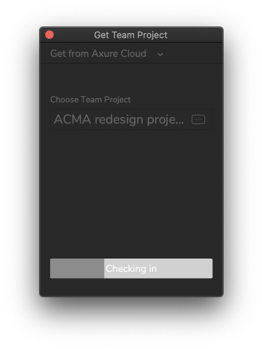

My team and I just switched over to Axure 9 Team, from Pro. We’re all using Macs as well and experiencing the same problem.
On our Macs we are also seeing errors checking out / getting updates from individual pages. If we attempt to “Get all changes from team directory” or "Check out/in everything " under the team dropdown Axure will also freeze at the ~30% mark. However on my Windows PC everything works with no freezing.
